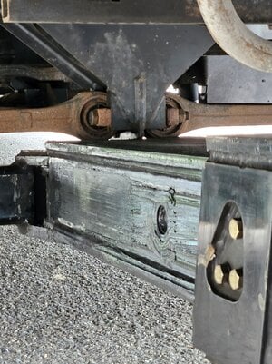

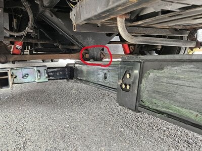

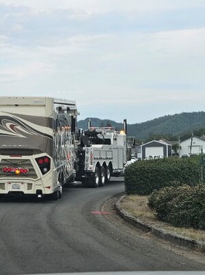

Now for the tow.....Alpha Tow Company arrived with a four axle semi tow truck. The driver said the particular truck he brought was designed specifically for towing IFS front end motorhomes. It used a large boom that extended under the front end of the coach and would lift the front end by sliding two bars under each front wheel and lift the coach by the wheels.
This is where we ran into an issue. The newer Freightliners with IFS have a large "V" shape frame in the center of the front end (see photos below). That
V" shaped frame, at the bottom, holds the front "A" arms. The driver slid the boom underneath to lift the tires, once the coach was in the air, the frame of the coach was hitting the boom arm. Since the coach will bounce as you go down the road, as the air suspension is active when you lift by the tires, it meant the coach frame was going to keep striking the boom. After multiple calls to the toe company owner and other drivers, they had no real solution.

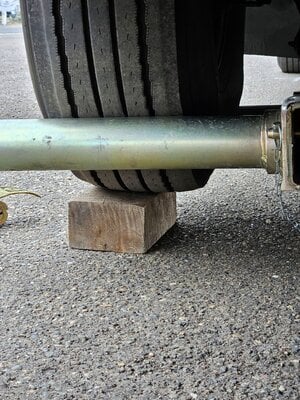

The way to make the boom system work is to move the two arms that go under the tires closer together. By doing that, it allowed for about 2" between the frame of the coach and the boom arm. The issue with doing this, is the two arms create a cradle for the tire(s). However, the closer the arms are placed to each other, less of the tire is in the "cradle". Even though the tires are strapped to the cradle/arms, in a sudden stop, the coach could literally roll out of the "cradle".
We eventually found that we would have to go with the arms close together. He strapped the tires as tight as he could and then I added air to them to increase the tension.
The fun didn't stop there. Now that the lifting of the tires was resolved, we needed to disconnect and remove the driveshaft. While he did that, I ran an airline along the side of the coach all the way back to the air dryer so he could hook into my brakes. Then a second airline under the front hood to keep the bags aired up. Finally, a wireless light system was hooked to the engine cover.
The above took three hours, just to get the coach safely loaded and ready for towing. I was very appreciative that the tow truck driver hung in there with ail the issues, as I think some would have given up and left us there.
