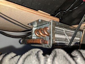

I don't think I can simply turn the Oasis burners on, correct? I don't want to turn the Oasis burner on for the hot water since I have drained the water out of the coach for the 20-degree projected temps tonight. I am hoping setting the thermostat to furnace for zones 1 & 2, I have engaged the Oasis System which will also heat the wet bay?
Peek into your wet bay above the fresh tank, high up there, you'll see a heater. OASIS needs to be on one way or the other to make heat, water has nothing to do with this. No need to drain tanks but if you're going to winterize then go all the way.
Thanks, I will grab a flashlight and check it out. Thanks again
You can run Oasis with the water system drained. Oasis is a closed-loop system that heats a special boiler fluid, not the water directly. There is no interconnection. When heating water or the coach, an indirect heat transfer occurs from the closed loop boiler fluid system. Our coach has had the Oasis system running for the last two weeks during a cold weather spell; with the water system drained. No harm done.
