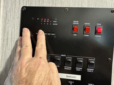

Here is my tank sensor. Now, 3:00 PM, it shows 2/3 full but still no water to faucets with pump on. Temp 27 low tonight in teens.

I don't trust pump sensors, ever. And it sounds like you have a frozen spot in the pump piping. Check the input side of the pump, I have seen a lot of the screens freeze first. If you can, get some heat on it.
Hair dryers work for this.
