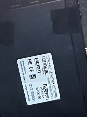

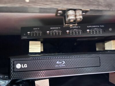

I have a 2021 Fleetwood I purchased from original owner. I replaced the Connexx 4 x 4 HDMI matrix unit about 18 months ago. The new unit worked for a while, but now all the lights are flashing green on the panel for each of the 4 devices. I have unplugged it an reset it but still all lights are flashing green??? Any suggestions on how to get it working properly again would be greatly appreciated. Thank you!!

check that you have 5 volts DC to it. If yes, throw it out.

I would disconnect all but one, and see if that one works. Then add second / third / fourth. It is highly doubtful that all cables died at the some time, unless lightning etc. If all lights are blinking, that suggests a low output power supply. Or worse, a fried matrix.

@GDFleetwood Check the power supply output voltage. My guess is that it's bad. I had the same symptom and it was a bad power supply. If I recall correctly I believe it should be 5V but in most cases the unit will be labeled with the output voltage.
I had same issues, swapped out the king satellite power supply because we needed it in a pinch and that worked perfectly. Ordering a new power supply as I type this. Can't find the exact one, with the security locking nut, but I'm not too worried about that.
