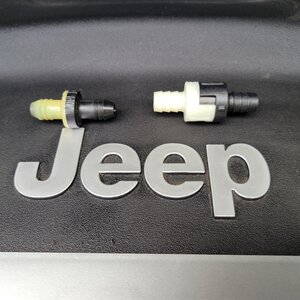

I received the new version of the check valve yesterday from Demco. You can see in the picture below it's a new design. I was told by the tech at Demco the new check valve is from a different vendor and it is spring loaded.
New check valve on the left and original on the right.

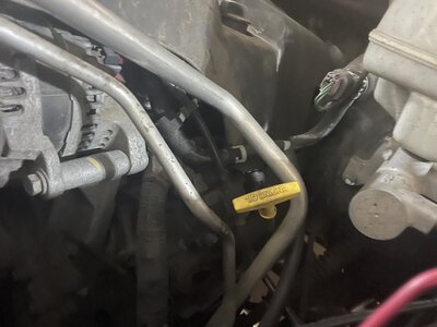

Neal, attached are pictures of my '13 dodge 1500. The principal is the same. Look for the vacuum line going to the vacuum booster(probably a half inch line). One check valve goes in there followed by a tee. One side of the tee goes in the line to your vacuum booster. The other open space on the tee goes to the air force one controller. The other check valve goes in this line. The check valves allow the air force one to create vacuum just for the vacuum booster, not the entire vacuum system on the toad. The other check valve prevents the toad from losing vacuum through the air force one while under it's own power.

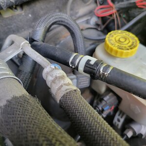

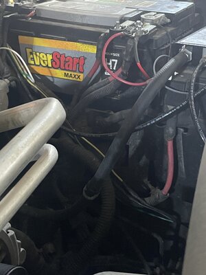

See below the pictures of the Air Force One control box on my 2022 Jeep Wrangler, the vacuum line coming out, and the location. There is a second one on the right side as well where the vacuum line continues on. As you can see, my tech at TransWest replaced both check valves with the new ones.
