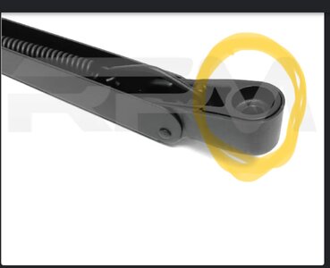

So there is a connection from the arm to the shaft that slipped letting the arm hang down?
It sounds like a similar situation we get with Newmar coaches wherein the soft metal of the wiper arm loses its grip on the motor spline.
Try removing the arm and placing some aluminum foil inside the part that goes over the spline. Then torque the nut down (mine is specd at 70 ft-lbs).
When you get the new arm, retorque it every six months.
I used thin stranded wire with the insulation removed. Both should work.
