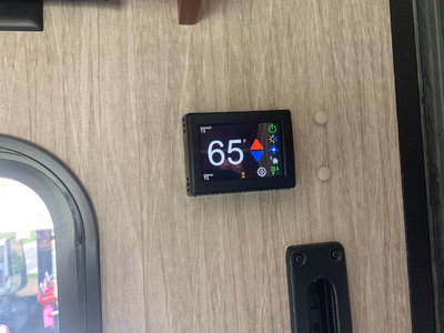

Installed mine today- hoping the AGS update is not far off. My only complaint thus far is that the unit does not cover the old mounting holes. Has anybody found a decent way to patch these holes in the Newmar interior walls? I’ve also got some where my wife took down the valances to mount some custom stuff.
View attachment 7128Installed mine today- hoping the AGS update is not far off. My only complaint thus far is that the unit does not cover the old mounting holes. Has anybody found a decent way to patch these holes in the Newmar interior walls? I’ve also got some where my wife took down the valances to mount some custom stuff.
My Micro-Air came with screw cover.
