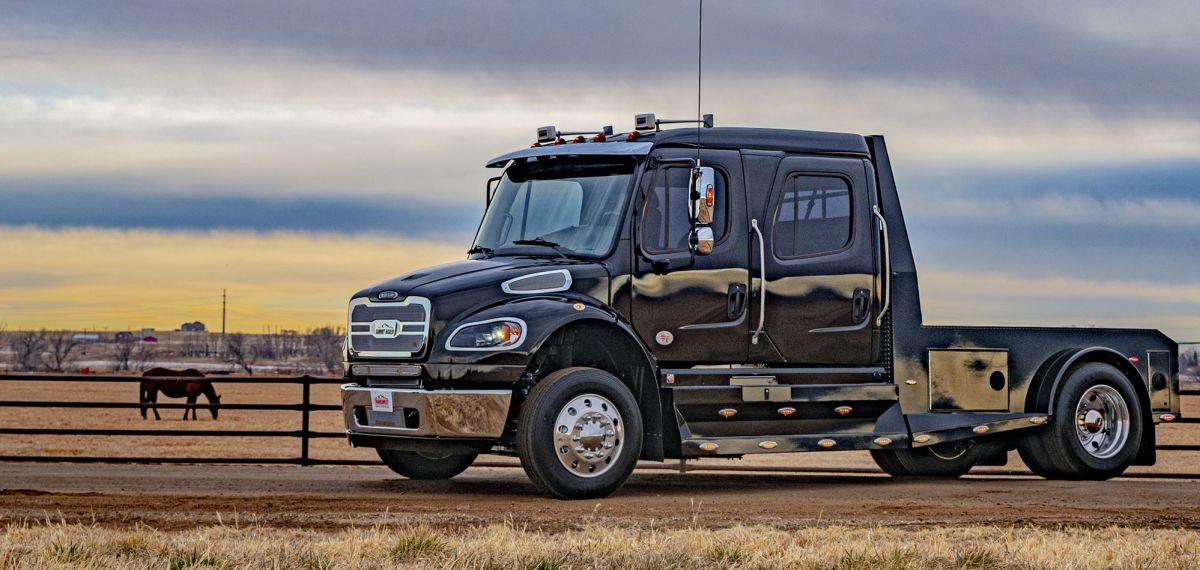

It has seemed to me that the F4 50 it’s somewhat limited in additional capabilities as mentioned. Now the F550 can get you up to over 30,000 pounds GCWR, and provide a nice level of overhead. But I believe that’s for commercial applications and I’m not sure what your ordering options are as far as the bed goes. But I always thought if I went back to a fifth wheel that would be a pretty cool way to go.

John, there are probably 3 or 4 MDT's (medium duty trucks) on sites in our current winter resort that pull larger fivers. A few years ago I rode in a newer model (bob tail) and it certainly was not as smooth riding as my F350 I had at the time. How an MDT rides when hooked up to a fiver I can't comment on because I have zero experience.
