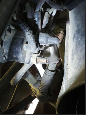

the red cable from positive battery terminal goes to some sort of a 4 post device. All 4 posts have power. One post has a thick (8awg?) wire that goes directly to the positive side of my house batteries. I presume that this connected to the booster to allow the engine to use house batteries as power to start the engine. The other wires disappear behind the rubber wall to unknown locations. Would it be fair to say that one of those wires goes to the starter solinoid with a a fuse somewhere in between? If this is correct and that fuse is blown, would that cause all chassis-related lights to not work? I have yet to trace the wires back from the starter as it is very cramped and I'm working alone. I also have a photo of a small component but having trouble attaching it to this posting.
could this component be a relay associated with the starter? It is in the engine compartment on the left side attached to the wall. One lead appears to be a think red cable and one appears to be black.

Well Pat. In the back of my mind In the web of forgetfulness, I pictured your relay. Based on the year, and knowing Ford has the so-called better idea. I was able to guess the maker.
You can hot wire at that, what I call a solenoid. Jumper between the larger cables and the starter should crank over the engine.
If it does jump between the battery side terminal and the smaller terminals one at a time. The engine once again should crank. If it doesn't the solenoid has failed.
If she cranks make sure the terminal that you jumped gets power to it when you turn the key to the start position.
If you get this far. You have one of many problems. A bad relay in the relay box. A bad key switch. Or (PCMsignal,fusible link,or main fuse/relay).
