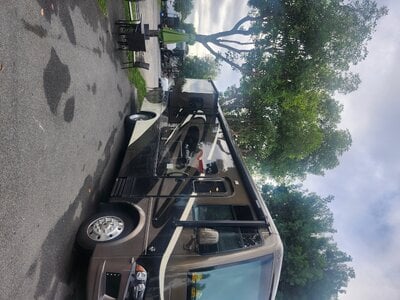

Well after owning my new to me 2018 Newmar Bay Star for a few months, finally got out for our first trips.
About a 200 mile round trip to Prescott for a couple nights for Christmas and then about a 700 mile round trip to California for a couple nights for New Year, both trips we had full hookups. After first trip found out the igniter didn't work on the stove but replaced it before the second trip. Ran the furnace on propane worked great also used the Heatpump for heat worked well just noisier then the furnace. Also ran the waterheater on electric and propane without issues, all in all we had a great time and love the coach. The only real complaint I have is the way it handles on the highway passing or being passed by big rigs. I'm in the process of finding somewhere to get new tires and will get the alignment checked. It has the original michelins, does anyone have a recommendation in the Greater Phoenix area for a shop to get tires and an alignment? I'm on the west side in Goodyear but will travel as needed to a good shop.
Thanks for any suggestions.
The pics are California forgot to take some in Prescott.
