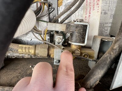

Hello,
We have a 2018 Coachmen Clipper UL 17BH with the RM2351 compact fridge.
When we purchased it from its original owner, he had it plugged in at his house and the fridge was cold and working.
However we cannot get it to work on gas. The stove works, heater works. We have tried running the two burners on high and changing the button to gas on the fridge but it just cycles through its 3 mandated attempts to activate and the check light comes on.
I checked the little dial inside the back housing to make sure the gas valve to fridge is turned on and it is.

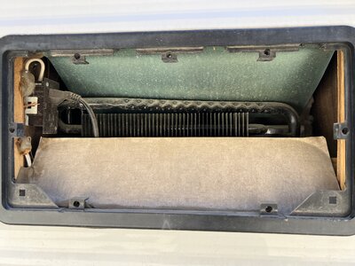

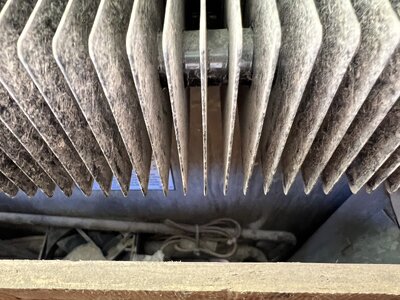

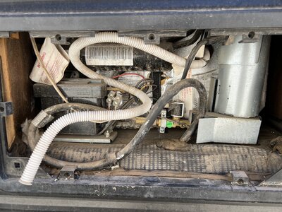

Advice or ideas? Attached photos - the top exterior fridge panel has a piece of thin board glued in, is that supposed to be there?

When cycling through its three ignition attempts:
Does gas flow through the nozzle?
Does the igniter spark or glow?
It needs heat, fuel, and air. One or more of those must be malfunctioning.
And/or, the control board could be bad.
If it hasn't run in a while, it could be the valve is stuck closed. I have this issue with my gas fireplaces in my house. A 'gentle' rubber mallet tap usually clears it with the valve open.
So I recorded all 3 attempts but to sum it up, the first ignition attempt has only a glow with no flame. The second and third attempt, there was red glow and blue flames. But it still kicked off and went to check light after.
The on/off button on the fridge is very finicky, sometimes it sticks in position and doesn’t cycle on or off the first time correctly. We have to mess with it. Is that what you mean by control board?

You might want to tap on that aluminum flue to see if it’s clogged. If the previous owner didn’t use the gas function, critters could have gotten in there and gummed up the works.
