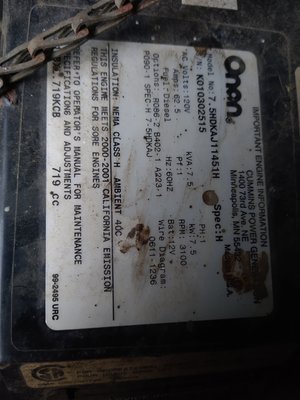

It is an "Onan Quiet Diesel 7500"

I have an Onan 7500 diesel on my work truck. The gen wont start if its low on oil so that's the first thing I would check. If it runs out of fuel it takes a while to get fuel back through the injection pump before it will start also. How many hours in it? Was it running normally and shut down on its own? Did you shut it down and now it wont start? The starter switch on the unit should flash a code if it wont start or shuts itself down. Is it flashing a code?
