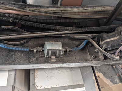

We have a 99 pursuit that has been sitting with approx half a tank of gas in it for about 2 years.
It cranks over but does not start. All fuses and Relays are good.

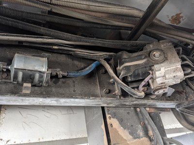

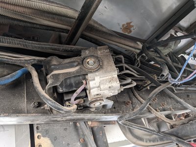

A lot of posts have mentioned that the fuel Pump in a 1999 is in the tank. And here's where i need help. Is this a fuel pump in the pics, which is on the driver's side front rail?.
Any advice would be greatly appreciated.

Well for starters the fuel is no good. The second pic is the fuel filter. Not sure if that is the fuel pump. You need to start by removing the old fuel and putting fresh gas in it.
Thank you for the reply.
I will start siphoning!
