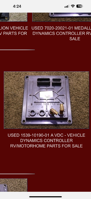

My wife and I have a 2004 bounder diesel 39z. We have had it gone through by a certified Freight liner repair shop. After several major repairs our gauges still don't work. The problem is the VCD is not in stock or available at this time. I have found a used one that I can purchase. The problem is the Freight liner service doesn’t want to flash/program it. They are very hesitant about use parts. We are located near Pensacola Fl. Does anyone know of a service that could do this for us? Attached is a picture of the VCD

Welcome to RVforums from Ely, Iowa. Please complete your profile so we can know more about your RV. Also what acronym VCD? Are you sure this needs to be flashed?
I think what was meant is VDC.
As described in the picture, VDC - Vehicle Dynamics Controller.

We have a 2004 Fleetwood Bounder 39z powered by a Cummings Diesel 300. The vehicle has 144K on the Odometer which is the only gauge working.
