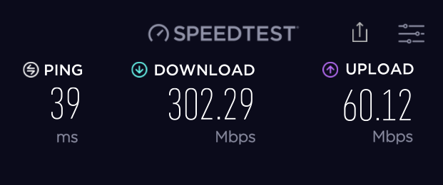

Verizon prepaid unlimited approx 7 AM in a Pepwave BR1 Pro 5G.
@Neal, I know very little about this stuff, but what is it that gives you such tremendous speeds? I have a verizon prepaid mobile wifi, and I can’t get anywhere near that in ideal conditions.
First and foremost a 5G cellular device (CAT 18 or better, i.e. 4 cellular antennas) such as the Pepwave BR1 Pro 5G (price just reduced to $999). I don't know that a roof antenna is required in a fiberglass coach but I do use a Parsec Husky cellular antenna mounted on top of the air conditioner shroud. My roof antenna setup would be even better if I didn't have 15ft cables but it is what it is for now. Shorter the cable the better.
My AT&T prepaid 5G is also fast here, I'm probably in a 5G fringe area, both AT&T and Verizon are showing 5G connections, but honestly that means nothing to me. Yesterday on arrival both carriers were north of 150 down at 4 PM.
