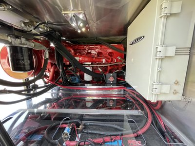

Hey there; thanks for thinkin. But, first of all, that entire electronics overhead cabinet is air conditioned and vented across the bottom. (My DS was horrible and non vented at all.)
But the issues coming from heat are in other places such as the load center in the engine bay, the electrical bay, and even the door mechanics.
So, in this case, “electronics” aren’t the problem children as usual; it’s their evil “electrical” cousins! ?

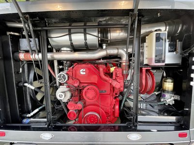

OK, now who is detailing your engine? It looks like just came out of the showroom ? You must wear sunglasses to look at it?
I cannot tell a lie,
For it is 3 people
Me, myself, and I.
But Newell gave me a headstart by building a spectacular engine bay to start with!!
