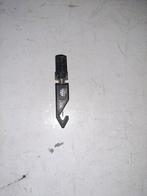

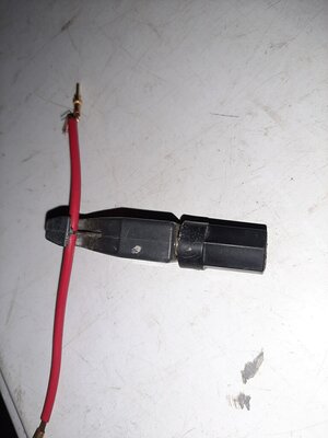

As a “last shot” he used a small tool (picture added) to pierce a wire that he used to jump the ECM in pin 70. When he did this, she cranked right up and ran beautifully for close to a minute. As soon as he disconnected that wire from pin 70, engine died. He then told us it was an electrical issue (obviously). CAT wants almost $5k for a $300 part replacement, 3 visits, and 14 hours of “labor” (head scratching). After messing with the ECM our dash now stays on (as shown in picture) when the key is in off position and even removed. We turned our batteries off to protect them of course but this issue did not exist before he toggled with the ECM.
If anybody has any idea how to get power sent to the ECM in pin 70 when key is in the crank position, please help!! We are almost certain that will get out girl back on the road!
