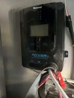

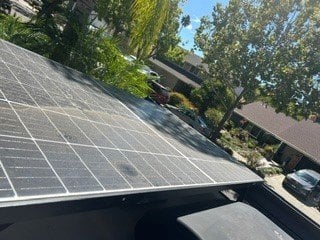

1) The previous owner installed the solar panels and the Renogy Charge Controller. We have the app to monitor the charging status.

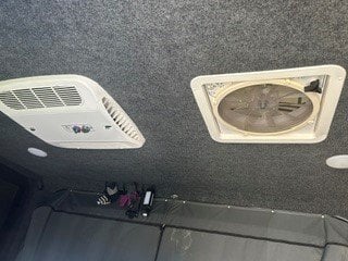

4) At the camp site, we connected the trailer to the 30amp power source. We still kept the solar charging plugged in. Immediately we smelled the burning smoke inside the trailer. We tried turning on the ceiling lights and the fan and nothing worked.

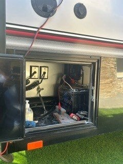

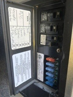

6) We opened the electrical panel and saw a burnt mark on the last fuse (according to the label, it's the LP Shutoff, please kindly explain what it is for).
7) We turned off all the breakers and unplugged the 30amp power from the camp site. Then we replaced the burnt fuse with a new 15 amp fuse.
8) We turned everything from (7) back on. The lights / fan still didn't work.
9) We turned all the breakers off and on again. Unplugged and plugged the 30amp power again. Turned the lights on and still didn't work. However, there was burning sound and this time, the second to the last fuse (according to the label, the Vent) was burnt.

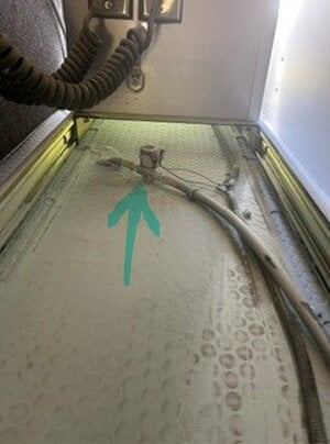

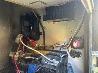

10) We turned off all the breakers, unplugged the 30amp, replaced the fuse, and turned everything on. Still no lights, but about a minute later, a small fire started inside the cooler/stove/battery compartment. It was from a vault (see the blue arrow on the attached photo) that has 2 lines out, 1 going to the original gas stove we removed, and the other going into the propane tank which we removed. Basically both lines are not connected to anything, and we left them unconnected under the slide-out, as we don't like to use propane or gas. Perhaps this is where we did wrong, as I recalled the "vault" was warm to touch when we disconnected the stove. We thought it would not be a problem since no propane tank was connected. Perhaps the battery continues to "warm" the vault and because the battery was overcharged, it made the vault extremely hot and started a fire??
11) So, the fire started at the vault, fortunately we caught it and used the fire distinguisher to put out the fire.
12) We were scared. We turned off the battery knob above the battery (the battery shutoff). Then we turned off the converter breaker (the last breaker on the panel).

14) We are now back home. We am hoping someone can guide us as to what happened. The battery app says the battery is overcharged. Maybe we burned the fan and the lights? I am not sure. The Renogy Charger Controller is still off even after we turned the battery shutoff back to ON. We are currently not plugged into any 30amp source power.

I included all the photos, including the "vault" covered in white powder from the fire extinguisher.

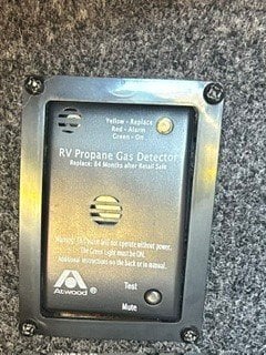

Also note, there is an RV Gas Detector (the black box) inside the trailer under the tip out bed. The light was red after we had disconnected the stove from the vault. We just "ignored" it...After the recent incident, there is no more light.
