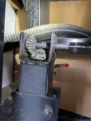

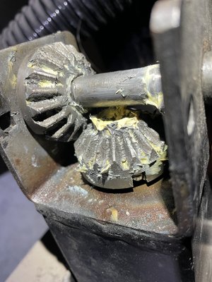

Hey guys I have a 1999 Forest River Salem 26bh. I’m having a problem with the front stabilizer jacks retracting on the passenger side (right side). The gears are missing a handful of teeth and make a clicking clacking noise when going up or down. I’m having trouble identifying which gear package to get. I don’t see a manufacturer name anywhere. Any help on where to get started or how to tackle this would be appreciated.

My guess is you will need to buy the complete assembly. I really don't think you will find the gears. You may find them at a gear belt and chain supply house, but those will likely need to be machined to fit.
The whole assembly will be much the same no matter what brand and will fit right in without much fitting.
