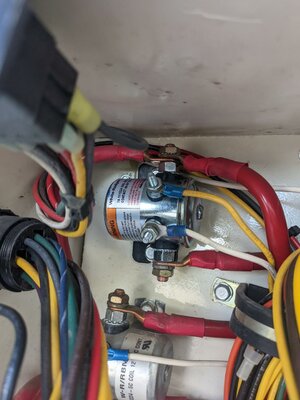

A few days ago after bringing in my slide on my 2000 Dynasty I lost all house power and the 120V system is very limited, and the engine will not start. It turns over easily when jumping the solenoid but wont start with the key in the start position. I can here the inverter trying to work but gives up and then the 120v goes out for a minute and comes back on by itself but it shuts down if I try to use the Microwave.
I checked the inverter and its working, green lite on the front of it. I have checked every fuse and breaker on this rig. I did replace one of the solenoids in the the front left compartment. I do have the ability to retract the front and left jacks buy not the one on the right that is slowly dropping the right rear of the coach.

You need to get your batteries tested for amp draw. Voltage means nothing when you put a load on them.
