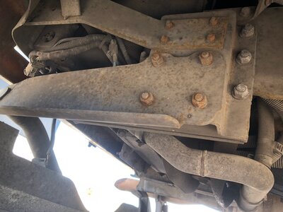

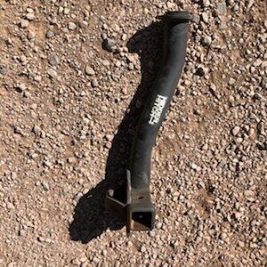

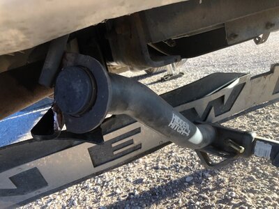

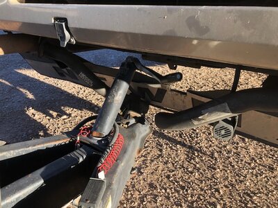

Have you ever had your trailer weighed? What was the tongue weight? Being in the business of commercial trucks where every truck I sell has at least one hitch..............most of the hitch failures I've seen were from being grossly overloaded. You know...........a guy has a Ram 3500 with the Cummins diesel that'll pull a mountain so he throws his 42' gooseneck trailer on the back with his front end loader and 12 pallets of sod..........then calls me to tell me my hitch failed. Turns out the hitch that was rated at 26,000 lbs was towing 42,000 lbs............repeatedly. Not saying this is the case here but I';d be interested in seeing the pictures of the hitch and the mounting brackets.
Here are some pics of Hidden Hitch

I found a post on etrailer that stated the hitch was discontinued and had a rating of 5000 lbs. I think you overloaded it.
I agree with TheLookks and think it was a combination of factors. First, a 20-year-old hitch that wasn't properly inspected and the presence of lots of rust. How miles/years has the hitch been abused towing above its capacity? Normally a 5000-pound hitch has a 500-pound tongue weight limit. Not sure which Jeep you have but my Jeep scales at 4800 pounds and adds in the trailer weight and is way over the hitch capacity.
