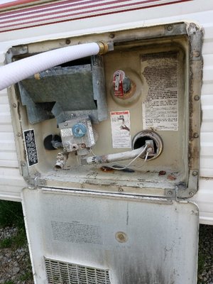

This isn't for me but for an elderly neighbor he just moved into a '92 Jayco. It's a propane heater and the part that is supposed to feed the propane won't stay lit. I'm not very technical because I'm a newbie. Ed is a veteran whose home burned down and is now living full-time in his travel trailer. We're at the Archie RV park in missouri, hour south of kansas city.
Any help would be great. Used part, new part, expert advice.

Blow out the combustion chamber. Turn on the stove and see if it lights and stays lit.
Looks pretty corroded. Might need a cleaning. Holes could be stopped up?
