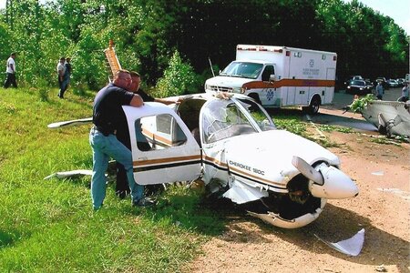

It's not old wife's tales as I have experienced it. I had an engine failure due to lack of use crashing in the woods of Mississippi. Granted an engine blowing up in a vehicle is not as critical but it's still costly. Below is the picture of the plane I bought with only 300 hrs on the engine in over 10 yrs. after 7 hrs. of flying, the engine blew. There was corrosion on the valve stems which caused one of the to stick open and the piston hit and shattering seizing the engine.

You win, you crashed a plane. Can't compete with that. But my experiences with old unused equipment is the opposite of yours.
