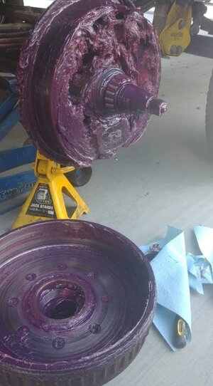

I agree with team bradfield. Although this was not on our previous trailer, it seems someone overpacked the Ez-Lube system. See below.
I always pull wheels and pack bearings by hand. That way I can inspect the races and seals and replace them if necessary.
. View attachment 17920
That’s one for the record books!
