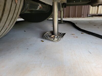

Well here's a first. Bought the 2023 frontier on July 2025. Drove 1400 miles home and one short trip (100 miles) since. Just noticed this damaged jack pad this week. Don't know when or where it happened. Parked on cement pad at home, a few gravel spots coming home. Maybe like this when we bought it? 4200 miles at the time.
I looked at the other one to see how to remove it and don't see any bolts or nuts.
Anyone replaced one of these?

I have had to replace a whole cylinder but never just the foot. They are available on Amazon but you will have to check to make sure you get a correct fit for your system. Google Search
There are a number of videos on YouTube. Depending on the make and model of yours, it appears that they may be a bolt on part.
Good luck.
I have replaced one of mine make sure of size and order the heavy duty replacement pad not the cheap metal stamped out ones as they bend easy. My coach has cast leveler pads on it which ar very sturdy.
Thanks, I measured yesterday and contacted lippert about ordering one. Waiting to hear back.

Update, foot plate arrived from fleetwood yesterday. Took only a few minutes to change out with a craftsman impact wrench. Simple and quick.
