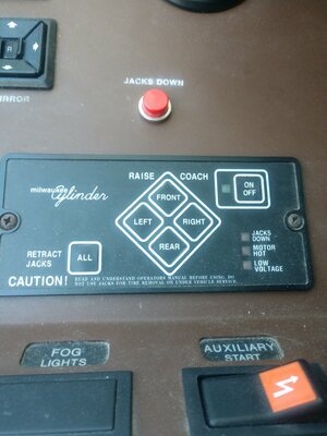

Newbie here trying to figure out my leveling system

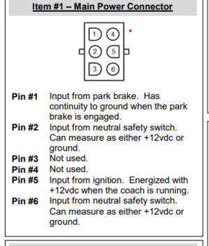

Have a 1994 Southwind on a Chevy chassis...Im working on trying to get my leveling system to work again, first thing needing to figure out
how I can bypass the parking brake sensor. Apparently been rewired because park brake is no longer wired to pin #1 like it should, that wire

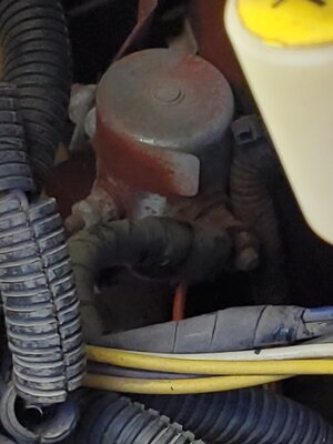

is cut and no longer going to anything. Reason wanting to bypass is it acts erratic, hard to turn on and stay on. Second problem, I replaced
main Battery and thinking I connected a cable wrong, there is a #2 cable connected to the solenoid should that be connected to the positive
