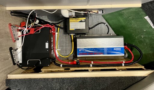

I installed in our Dusk:
800A SOK Li battery, with Bluetooth connectivity to the iPhone.
3000W inverter and automatic transfer switch.
Using the built in charger, just flip the micro switch to lithium.
Works very well
