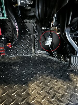

Has anyone been able to locate the brake controller connector or wires on a 2019 Pursuit (F53 Chassis)? On an older 2004 Liberty, I was able to locate a bundle that was labeled for the brake controller, but so far I'm not able to find any labeled wires or a connector that is labeled on the 2019 Pursuit 29SS that we just purchased.
Found it!
It was located down near the floor next to the firewall between the e-brake bracket and the fuse panel. It had a pigtail on it which I removed.
