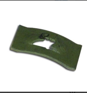

A trip to the hardware store for a bag of small flat speed nuts is your answer. 1000's of miles and no more loose fenders.
A few of us have found our fender skirts flapping in the wind. At issue is cheap and poorly installed self tapping screws used to secure the lower ends. They are screwed into a light angle iron support that is welded to the coach frame. Some are welded at the right dimension to catch the skirt and some are an inch too high leaving a gap that will not allow a screw to maintain its torque. I came up with a better plan using 1/4 inch machine screws with washers and flanged locking nuts to act as positive stand offs. These will stay on for sure. Just drill out the hole a bit and install as pictured when you find a loose or missing one. I will be doing the whole coach this way so I don’t ever have to worry about them any more.View attachment 19918
A handful of tinerman fasteners and no more loose screws. 1000's of miles tested.
