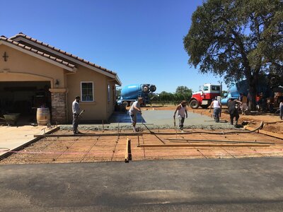

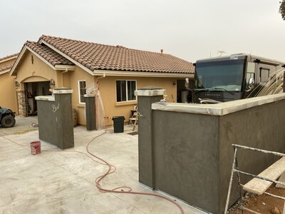

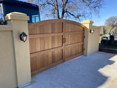

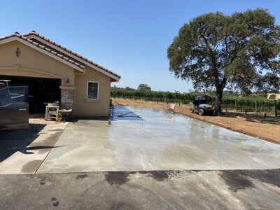

Coach parking at home (note there’s room for about 10’ of extra coach):93C7E744-E1EE-49A6-B59F-C3E37AA71D3F.jpeg055F4860-0B0D-46A0-808F-CBE2B9AA4406.jpeg

Coach parking at home (note there’s room for about 10’ of extra coach):View attachment 15964View attachment 15965
View attachment 15966View attachment 15967
Very nice, Rich!
