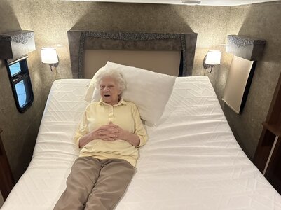

In ours was a full size king with metal frame. Ours went under the cabinets as well. We changed ours out to a full size queen, but I made my frame to be able to store things and made it low enough to put a 14” thick matress.
Also put servos in to raise and lower the head of the matress. My mom was the test subject. 😁
