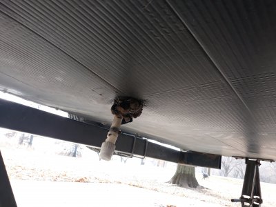

There are no signs of leaking from the ceiling or roof unless it's running down the inside if a wall. Today while working around the camper I noticed that the insulation around the seeping hose for the fresh water (?) was moist and dripping. So to clarify it is not coming from the hose but the insulation. I attached a picture of what I am talking about.
And to clarify the vent I originally mentioned is the furnace vent in the floor. And to explain more of the situation the carpet was moist the first few nights we stayed in the camper then dried up until the day I posted. There is also moisture in the outdoor kitchen.
