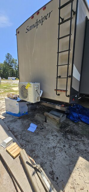

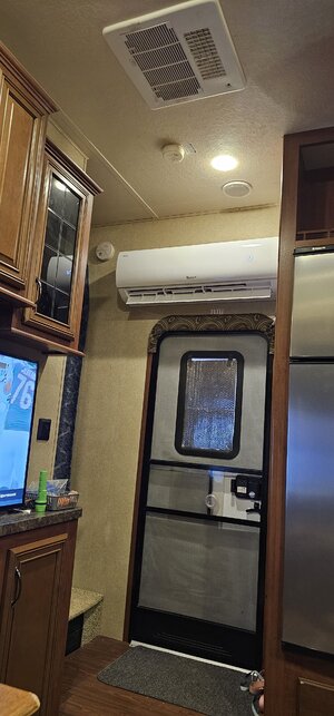

I would strongly suggest a mini-split!!!
Starting at 500 bucks, they are more efficient than any of the others above except the Medea inverter Window shaker that uses the same technology. Also much quieter!!!

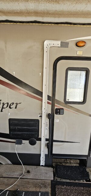

Funny you should suggest that, our park manager also suggested that last year, I did a little research into it and wrote it off one for one reason or another. Now I am strongly reconsidering it and sold on the idea and I saw Amazon has a 9000 btu model Amazon.com or this 11k btu model Walmart which I would hope would work well on our 30 amp system. I know there are install videos but I'm not finding anything specific to a class A like ours. So my question is where am I supposed to place the indoor and out door units in this model of Winnebago? Also the rear windows in the bedroom will have stay sealed unless I replace them. Any ideas?
Well in theory it's a great idea, but as far as placement it seems based on my search mini splits are easier to place on a Class B than a Class A, so far I have read how difficult it is to place a mini split in a class A and have yet to find a video that shows a successful install. The portable option starts to look more likely except the vent will have to go somewhere maybe through the floor?
