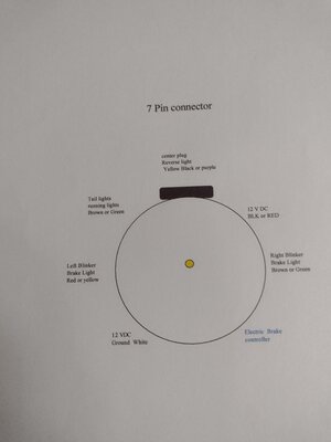

This might help for some of you guys.
That is only 1 configuration based on type and manufacturer. And is that the female plug, looking at it or the male plug, looking at it.
