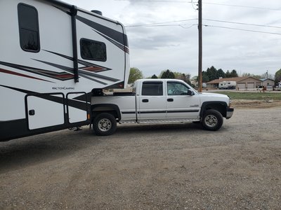

My brother in law, who has many miles all across the US, had an auto slider for a while. He said he would never get another one. He went with Andersen is is happy. I also have an Andersen and like it a lot better than the Reese 16,000# that it replaced, and it is rated at 20,000#. With the Andersen there are different configurations available, so it can be used with a short bed. I currently pull a toyhauler with a 2002 Chev 2500HD short bed and can turn about 80 degrees. The Andersen only weighs about 40# compared to the 80 or 90 of most hitches, so you are saving some capacity.
