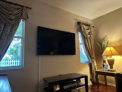

I’ve used these track channels to add outlets and hid the wiring. They make thin mount outlets and boxes as well. I’ve used them to add outlets without a lot of drilling and work.
One picture shows wall lighting I added in the RV and the other shows the power and other cords being hidden by the tracks.

Great solution! Thanks so much!
