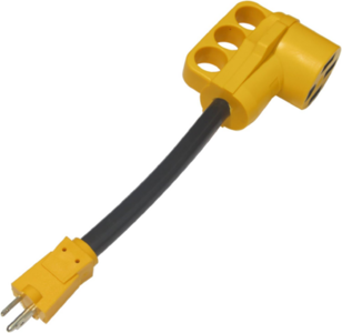

The cord, (dog bone) I use is similar to this one.

Welcome to RVForums, great to have you with us. Let me offer my simple solution - yes, I have this adapter and you can use 15A if needed to keep batteries charged. I also keep a 50 to 30 adapter on board so I can plug in to 30A outlets if 50A is not available.
