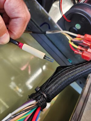

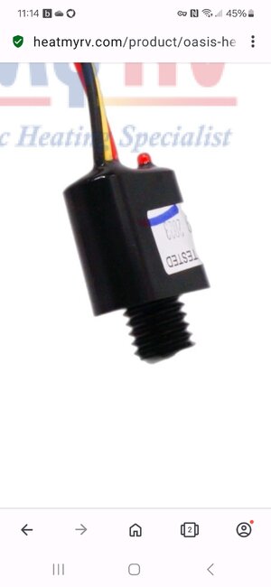

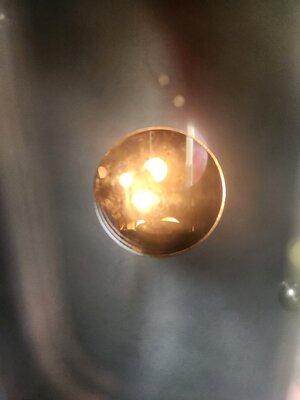

I'm on a trip in Central California where the temps are exceeding 100 degrees. Even though I had my Oasis unit go through it's annual service at the dealer back in May this year I'm experiencing flameout errors. The combustion fan starts running, then the igniter starts to glow, then the flame lights. More often than not I then see the flame out red LED light up even though the combustion chamber is all aglow burning fuel just fine, then the flame shuts off about a half second later. It'll automatically make a second attempt, often with the same behavior and result.
When I reset the Oasis I see the same behavior, but after about 3-4 reset cycles the flameout LED doesn't come on while the flame is indeed still burning and things are fine until the next time it acts up.
Any tips for dealing with the flame sensor, other diagnostics, or bush fixes? I am thinking the sensor or control board may be the issue.
