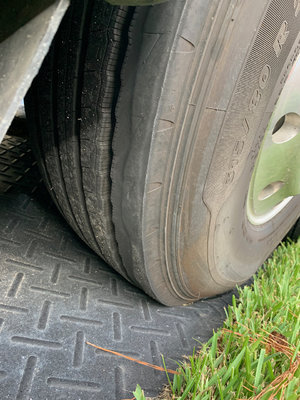

On my 2018 DSDP on a Spartan with 29,000 miles I have one tire that has an odd wear pattern. It's on the passenger side tag. It seems to have happened within the past 1,500 miles. The tire pressure is at 85psi (which is what Spartan recommended). Any idea what would cause this?

Ha e you had your coach serviced recently? Is it possible they rotated your tires?
Looks like a tax axle alignment problem. I‘ve seen many complaints about misaligned tag axles causing this kind of wear.
