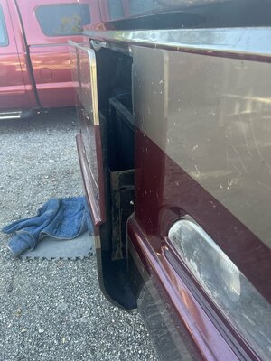

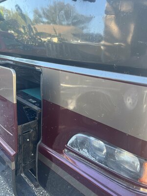

Hiya, I’m the owner of an 05 Monaco Dynasty, equipped with an Onan Quiet Diesel 10000 generator.
It creeps out from storage position? Maybe a couple inches a day?
The hydraulic Ram is not leaking, in fact the entire system is sealed and dry.
Any help solving this issue is much appreciated!
Thank you,
Dave 31EEB8A9-1927-4C28-9ADD-36CABBC7FF1B.jpeg89D1C261-493F-4D49-8D18-64D4B5061249.jpeg89D1C261-493F-4D49-8D18-64D4B5061249.jpeg
Have you had issues with cooling? I have the same coach, it used to creep. I pulled it in and ran the hydraulics to the count of 10. Stopped creeping.
I serviced the ding dong and now it leaks coolant. Thinking of cutting an access panel to look at the seam on the tank.
