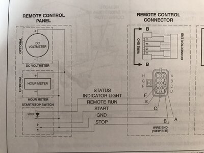

it appears the hour meter is wired into the remote control connector wires. You may need to remove fasteners to the entire control panel to see how the meter is attached.
here is a wiring diagram i was able to find. attached image.
