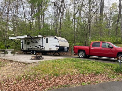

We are towing a 2016 Forest River 253RLXL Wildwood X-Lite with a 2011 Chev Silverado 1500 LTZ with the factory tow package. Works well for us although more truck would be nice. We are careful about loads and weights both in the trailer and the truck. Often we are at gross cargo weight for the truck but, according to CAT scales, we are at 80% tow capacity. Better to have too much truck than too much trailer.
As to Forest River quality, they are light-duty trailers, built to be lightweight towable units. It takes care and regular maintenance to keep things working correctly and the trailer looking good. I do all of my own maintenance. Just the wife and I so it is used and cared for by adults. We purchased it used and have had to replace and repair a few things largely due to abuse and neglect. About what was expected. Tires and batteries are consumables in about 5 years or less. The toilet was a poor design, leaked, and cracked so we replaced it with a much better quality unit. Other than cleaning and polishing, it is a dream to tow and to use.
Bob
