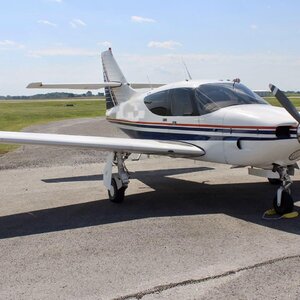

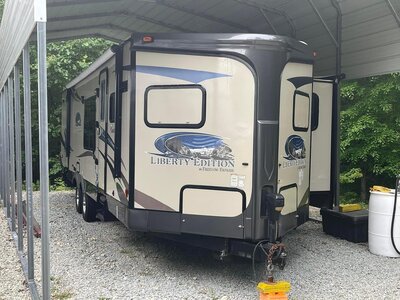

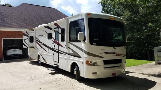

What I have done in these cases is us Zep High Traffic Floor finish putting it on with a clean micro fiber cloth in a back and forth movement. Looks like a new clear coat. I’ve done this for years. I used it on my previous MH, TT, and my plane.
