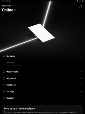

Tripped across the fix…. Subnet Mask for Management had to be changed. Now I can see it thru the mgmt IP and connect to the Starlink thru the Starlink APP while connected to the Pepwave Acess Point. Bonus!
255.255.255.255 (/32)

If I used the Standard Subnet Mask...all I got was a black page with a Starlink logo IF I used the address contained in the dashboard drop down. By changing the mask.....I can now get a true info page directly from the Starlink using the mgmt address 192.168.100.1
I found a thread on the Peplink forum. And someone mildly, almost unnoticed stated success with the mask change. It is at the end of the drop down. I tried it...and viola. So, it is one of the reasons I wanted to get the Starlink compatibility incorporated in the newer firmware. And I actually get dow load speeds now that are truly indicative of what Starlink should be capable of. Before...If I speed tested directly thru the Starlink router I got good speed...but thru the older pepwave I got speeds way lower than my Mobley. Didn't matter if WAN cable or WAN WiFi. It was SLOooowwww.
