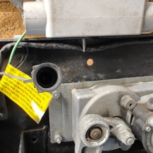

Phaeton step motor braker switch ?
Open storage bay directly under the drivers seat outside the coach. Look for fuse labeled "Step", "Entry Step", or "Steps".
Tiffins often have LED diagnostic lights. A red indicates the fuse is blown.
Look as well in the 3rd passenger side bay. The fuse chart on the door may have a listing for steps or steps cover.
There may be a 20 or 25 amp inline blade fuse underneath near the step motor in the wiring loom or in a small weather proof plastic holder.
Thanks
I've checked all the suggestions for finding a fuse or inline fuse in all the areas. Mentioned and have not been able to find anything. I did find this hanging wire. Coming down from the wiring harness. Anybody know if it has anything to do with the motor? I can't find the other end. If there is one.
