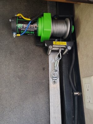

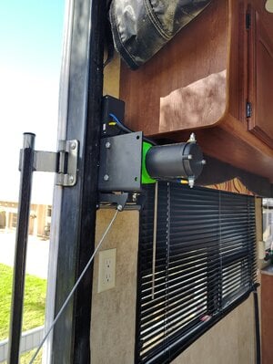

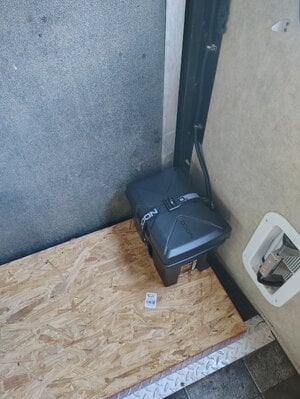

I recently fell and ruptured a disc in my back so lifting the ramp on my toyhauler is not an option for about 6 months. I decided to mount a small winch with a remote control in the rear corner of the trailer to solve the problem. Bought a 2,500 lb winch and reconditioned Optima blue top battery for a total $200 for the project. It works great
