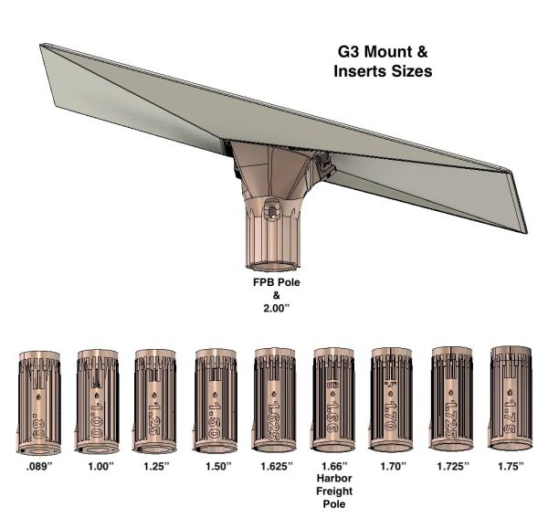

I also found my Flagpolebuddy Gen3 dish pole mount which I know they 3D print was poorly printed and the locking bar was broken off. Amazon sells this one which is aluminum and is working great. I'd much rather have a metal adapter than 3D printed.
As I ordered the pole mount from Amazon which is aluminum, I had also ordered a replacement from Flagpolebuddy.com. They've stepped up their game, this one is full on production plastic, not 3D printed, seems injection molded type thing, much higher quality and stronger. I'll be using this one next as it's more compatible with the pole mount plunger buttons, etc.
