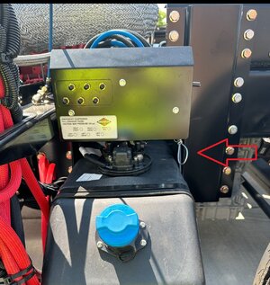

Found the pull lanyard to the tank in the rear of RV next to the DEF tank. Here is a representation from a Spartan display chassis.
