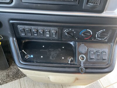

I’d like to open this up (without breaking it) to access the switches to check for power to a shade switch. I only found two screws and I can pry up the lower edge but at that point it felt like I would be forcing it enough to break it so I stopped. Anyone know how this is done?

Remove both drawers using the slider release on both sides of each drawer. One goes up other down.
After drawers are out you'll see screws on the face to remove drawer compartment. That gives you access. You're lucky as mine is out right now as I'm running wires from AV box to basement and this is the path out. More on that later.
Thanks - I’ll do that. Good timing!
If you pop the cover off your dash behind the steering wheel that will give you a look into the area too and you'll see all the wiring better. As you know 3 screws on underside above gauges.
Right - I didnt think of that but its good access too.
If you pull out the drawers below, there should be 2 or 4 screws that will allow you to remove the drawer assembly...and you should be able to see wiring.
