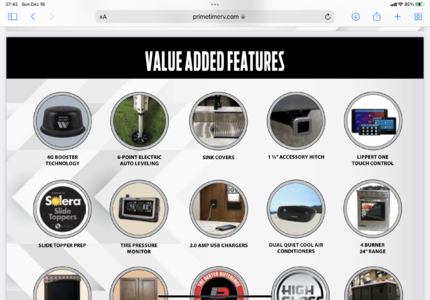

Pic below is from the brochure here: https://primetimerv.com/files/brochures/2022/2022sanibelbrochure.pdf . Is this 1 1/4” “accessory hitch” the one in question? The brochure doesnt mention specs but these hitches are fine for a bike tack or a couple hundred pounds of extra stuff on a rack, but thats about all you’d want to load on it.
